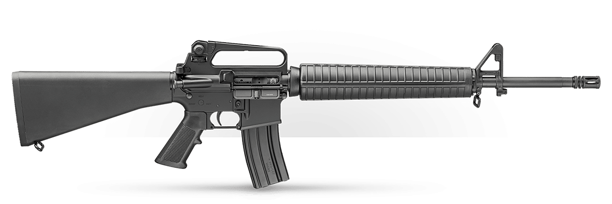

In this photo we see the Springfield SA-16A2 rifle, a clone of the original M16A2 rifle issued to the United States Marine Corps, United States Army and United States Navy. The original rifle was built by 	Colt's Manufacturing Company, but the Springfield Armory version is superior in every way.
The Springfield SA-16A2 rifle is a classic design based on the M16A2 rifle. It has all of the original features, but in semi-automatic form. Springfield Armory even added a few upgrades to enhance operation and performance.

The SA-16A2 looks at first glance like a virtual twin of the M16A2 5.56mm rifle. This impression is further reinforced by the “Property of U.S. Gov’t” markings on the lower receiver, as well as the “BURST” setting for the safety/selector lever. Yes, you read that second part correctly. But, don’t get too excited; naturally, the rifle is semi-auto only.
The Springfield SA-16A2 is a clone of the M16A2 military rifle. It is a semi-automatic rifle that fires a single cartridge with each pull of the trigger and uses part of the fired cartridge's energy to eject the case and load another cartridge into the chamber.
