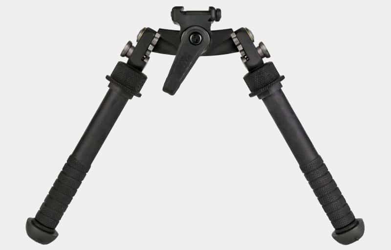

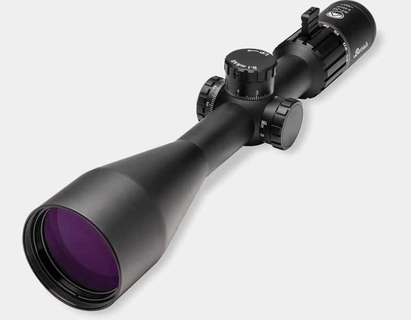

For testing, I fitted the ATC with a Burris RT-25 optic resting in a 20 MOA one-piece mount from Badger Ordnance. Thanks to the integral rail in the forend, I was able to attach my Atlas CAL bipod. This gave me plenty of magnification for anything I wanted to shoot at and a stable foundation for consistency. All kitted out to hit the range, the total weight of the rifle was now 12 lbs., 7 oz., unloaded.
