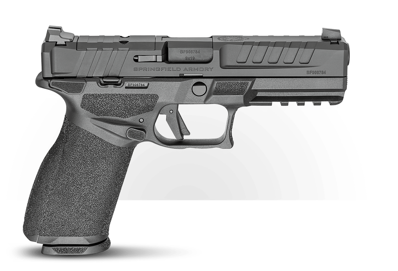

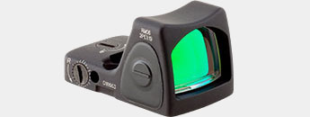

First, the basics. The Echelon is a full-sized, polymer-frame, striker-fired 9x19mm Parabellum semi-automatic pistol. Overall height (without the Trijicon RMR sight we mounted) is 5.5”. Adding on the Trijicon brought the overall height to just over 6”, and this minimal increase in height was achieved through the fact you can direct-mount the optic to the slide (more on that in a bit).
Overall length of the pistol is 8”. The slide is made of billet machined steel with a tough Melonite finish. The barrel is 4.5” long (unless you get the 5.28” threaded barrel Echelon). Both are hammer-forged for accuracy and durability. The pistol comes with two magazines — one flush-fit that holds 17 rounds, and one extended that holds 20. Reduced capacity 15-round and 10-round models are also available for restricted locales.

Remember I mentioned about direct-mounting the Trijicon RMR? You might think this means the Echelon has an optics footprint cut exclusively for that optic, and you would be wrong. Frankly, the optics mounting system for the Echelon is simply magic.
I’ve railed at optics manufacturers for years about developing a universal system for mounting handgun optics. It seems that everyone is determined to develop their own unique footprint for their sight and leave the mounting thereof to the gun companies.
Echelon 9mm pistol with manual safety
The author found the Echelon trigger was smooth and consistent to operate and broke at the vertical part of the stroke.
To address this, Springfield Armory has produced an amazing solution with the Echelon to allow their products to easily mount most reflex optics. They call it the Variable Interface System, and the idea was to create an optics area that was already drilled and tapped for mounting screws and featuring movable pins to accept as many footprints as possible.
Screws are great, but red dots really need a recoil lug to stabilize the whole arrangement. The Echelon’s system also provides a couple of posts that fit in mortises on the top of the slide. These posts have tabs inboard of the recoil stud that impinges on the base of the optical sight. The tabs are built in such a way that the mounted sight pushes down on the tab, camming them and the recoil stud into a very tight fit with the slide and the sight. My experience has shown the system to be rock solid thus far. And it does all this without adapter plates for the vast majority of popular red dot optics out there. Chances are your preferred sight will mount directly to your Echelon slide, allowing for a rock-solid fit and — in most cases — cowitnessing of the excellent iron sights. Like I said, magical.

Now that we have laid out the details of the pistol itself, let’s dive into the identifying feature of this newest model. This latest version of the Echelon adds yet another safety feature in the guise of a frame-mounted, ambidextrous manual safety. It’s located at the rear of the frame, similar in position to that of a 1911.
Springfield’s take on this useful little gadget is different than most I’ve seen. Textured tabs are mounted on both sides of the frame at the rear. By the way, the Echelon should be great for southpaws — all the controls except the takedown lever are ambidextrous.
Springfield Echelon 4-5F manual safety 9mm pistol
Although it is perfectly suited as a duty pistol, the Springfield Echelon 4.5F with a manual safety is also a great home defense handgun option.
While relatively unobtrusive, the location and feel of these thumb safeties should make them easy to operate for anyone comfortable with a 1911-style pistol. Flipping up the safety locks the trigger, though not the slide. The Echelon can still be loaded, unloaded or chamber-checked with the safety engaged. The safety can even be engaged when the striker is at rest.
The lever is thick enough to be activated easily with a very positive “click” when done. It is also small enough that the shooting thumb can ride on the outside of the lever. Everyone has their own idea of what a perfect safety is. For some, a flat, wide paddle-type safety that requires the thumb to stay high in the grip can be uncomfortable. If that’s you, you need to try the Echelon.

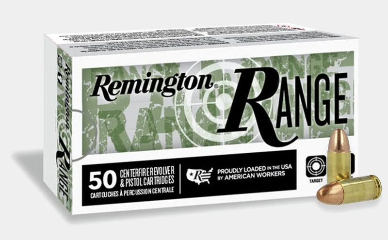

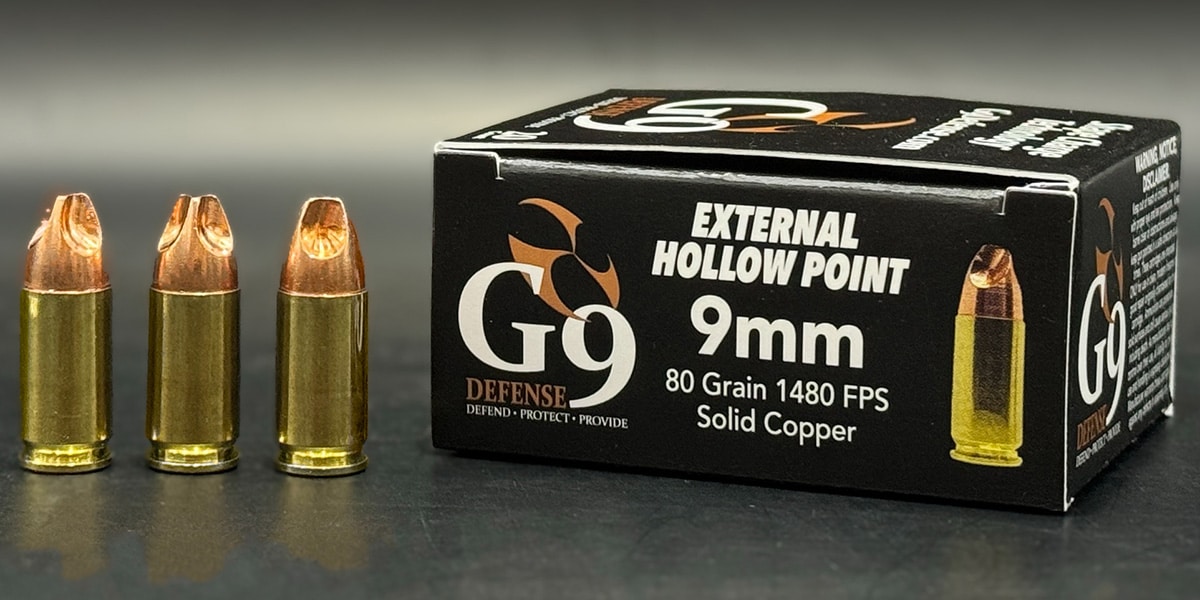

I tested three different kinds and weights of ammo. The first is the new 80-gr. screamer from G9 Defense. These pint-size little pills averaged 1,536 fps. which generated 419 ft lbs. of energy and grouped just under 2”. Next, we selected the tried-and-true Remington 115-gr. FMJ “Green Box”. These mid-weight loads chrono’d at 1,171 fps with 350 ft lbs. of energy and averaged 1.41” groups.

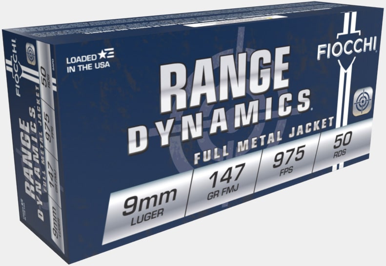

Lastly, we wanted to see what some heavier bullets would do in this Echelon and picked up some 147-gr. FMJ’s from Fiocchi. Looking like a great subsonic option, the Fiocchi’s chronographed 966 fps. with 305 ft lbs. of energy and 1.49” groups. Average group size across all three types was just over 1.6”. Of course, this Echelon functioned perfectly – and we gave it plenty of chances to fail.

Fiocchi 147-gr. FMJ966 fps305 ft-lbs1.13″1.49″
G9 Defense 80-gr. Monometal1,536 fps419 ft-lbs1.18″1.98″
Remington 115-gr. FMJ1,171 fps350 ft-lbs1.12″1.41″
Accuracy results for three, five-shot groups measured in inches at 15 yards from a bench rest. Velocity is the average of 10 shots measured in feet per second (fps) by a LabRadar Chronograph. Abbreviations: FMJ (full metal jacket), gr. (grain), in. (inch), fps (feet per second), ft. lbs. (foot pounds of energy).
