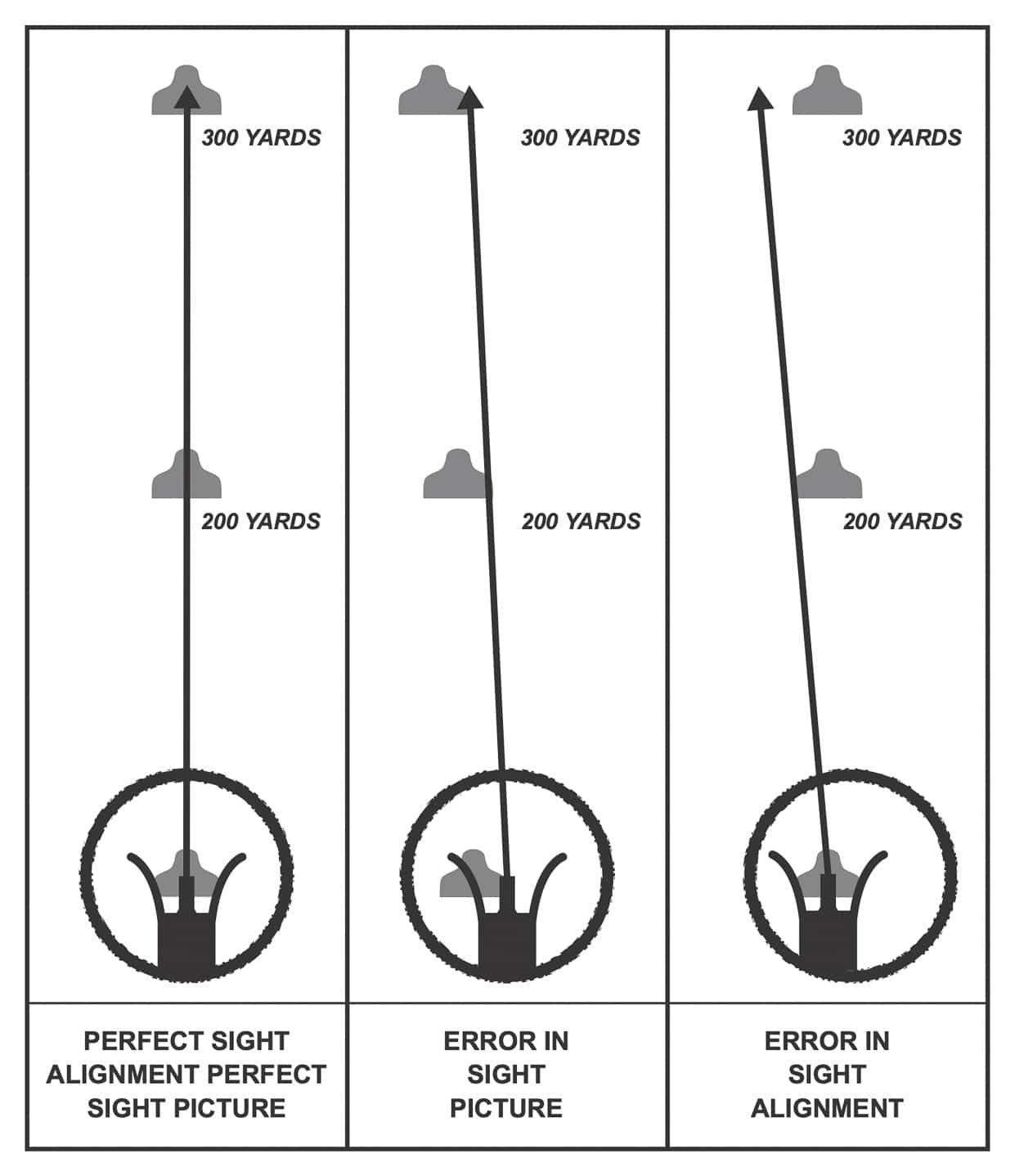

At close range, incorrect sight alignment has minimal effect on bullet impact. However, at long range a small error in sight alignment means a shot that hits off target. Image: U.S.M.C.

Sight alignment is crucial. At close distances like 10 yards, sights that are not perfectly aligned will have minimal effect on point of impact. At longer distances, as with rifle shots at hundreds of yards, a small error in alignment will cause the shot to miss dramatically.
