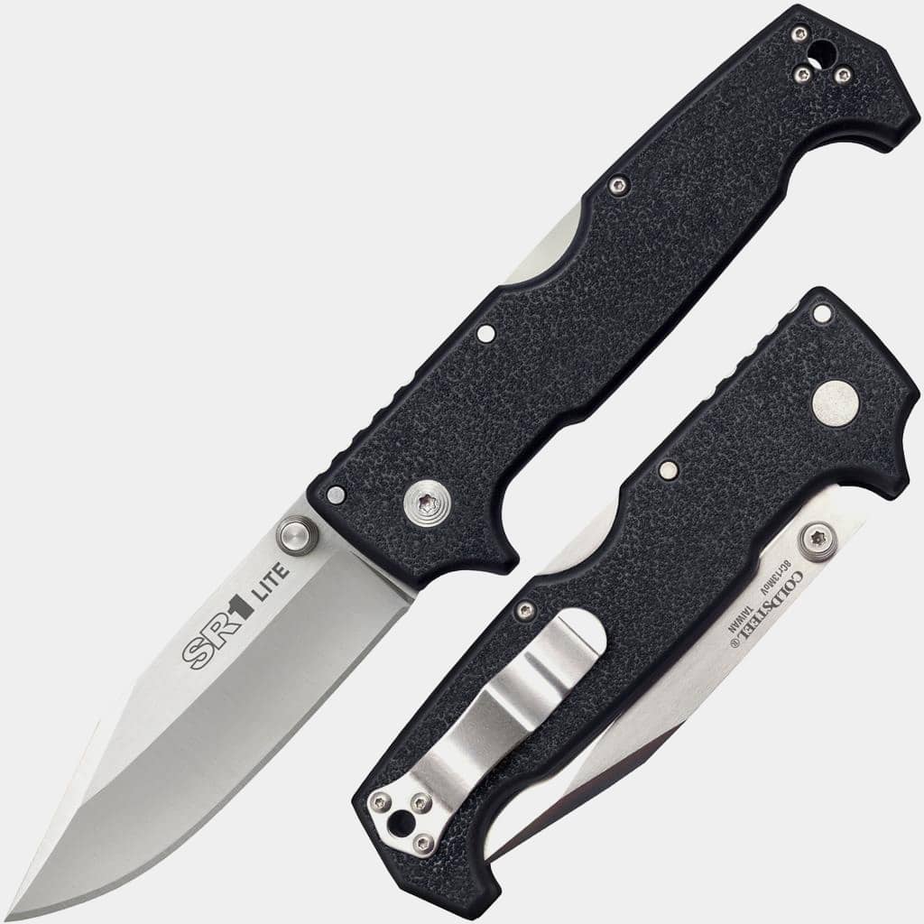

Cold Steel SR-1 folding knife
Cold Steel’s SR-1 Lite folding knife has a street price of under $50. At that affordable price, users can get a good blade with an extraordinarily strong lock suited for hard use.
If you buy a quality knife from a good manufacturer, it may arrive hair-shaving sharp, but almost always it will have a good enough factory edge to cleanly slice through printer paper without ripping. My $8 knife did neither, but had enough sharpness to catch a fingernail. That said, whatever middling amount of sharpness the blade had dulled considerably after cutting through about 14 linear feet of cardboard. In plainer terms, it was toast in about three minutes of honest work.

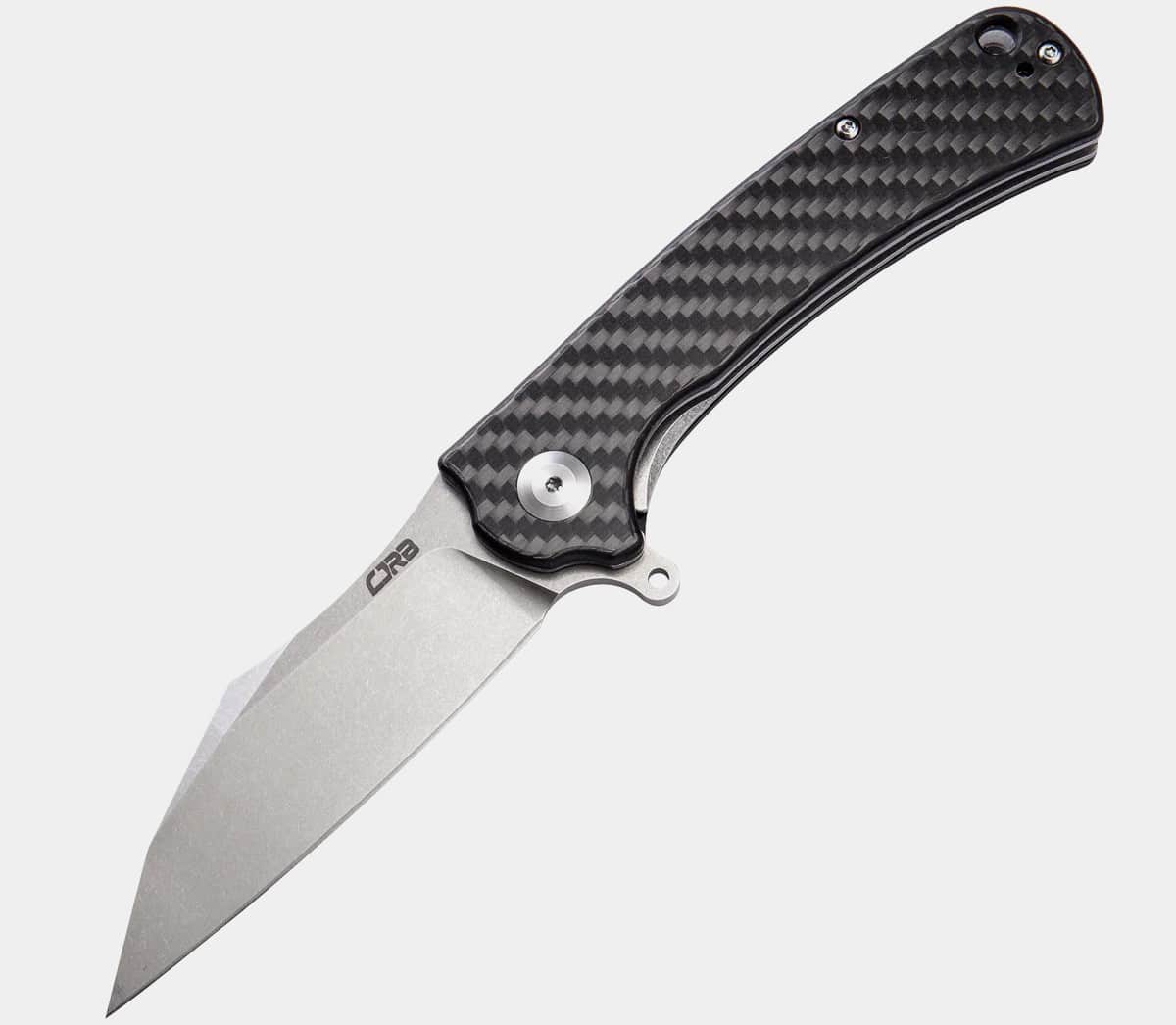

At the sub-$50 level of most quality manufacturers, you’re going to find a lot of G10, a compound made of epoxy and fiberglass. G10 isn’t cheap—it’s inexpensive. Easily milled and shaped, G10 has excellent strength, temperature resistance, insulation from heat and electricity, and is naturally water-resistant. It also has a good texture that stays put in the hand, not unlike a high-grit emery board. G10 can also be milled to make it even more grippy.
quality G10 handles on CJRB Talla knife
The CJRB Talla features milled G10 for a secure, positive grip. G10 is a laminate material the is extremely durable and chemical resistant.

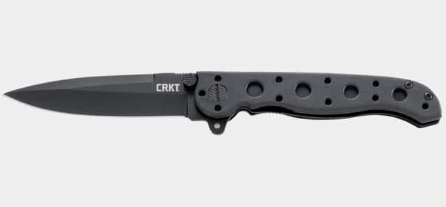

While my advertised knife was billed as being a liner lock design—and while it certainly seems to have a lock bar—I was surprised to find that the liner didn’t actually engage with the base of the knife when opened fully. In fact, I needed to hyper-extend the knife blade to get the lock bar to click into position. I would add this was only possible due to the play provided by the plastic materials.
CRKT M16 folding knife lock
CRKT’s M16: this variation provides the security of a frame lock, making accidental closure very difficult.
Suppose someone was actually to use this for a job requiring a reasonably tough material to be punctured. I’m not talking trying to stab this thing through a car hood—let’s just say that the task of the day requires poking through relatively thin PVC or plastic tubing. Without the lock engaged, and with the knife being pushed and wiggled, it’d be very easy to see how this thing could close right on a person’s fingers!
