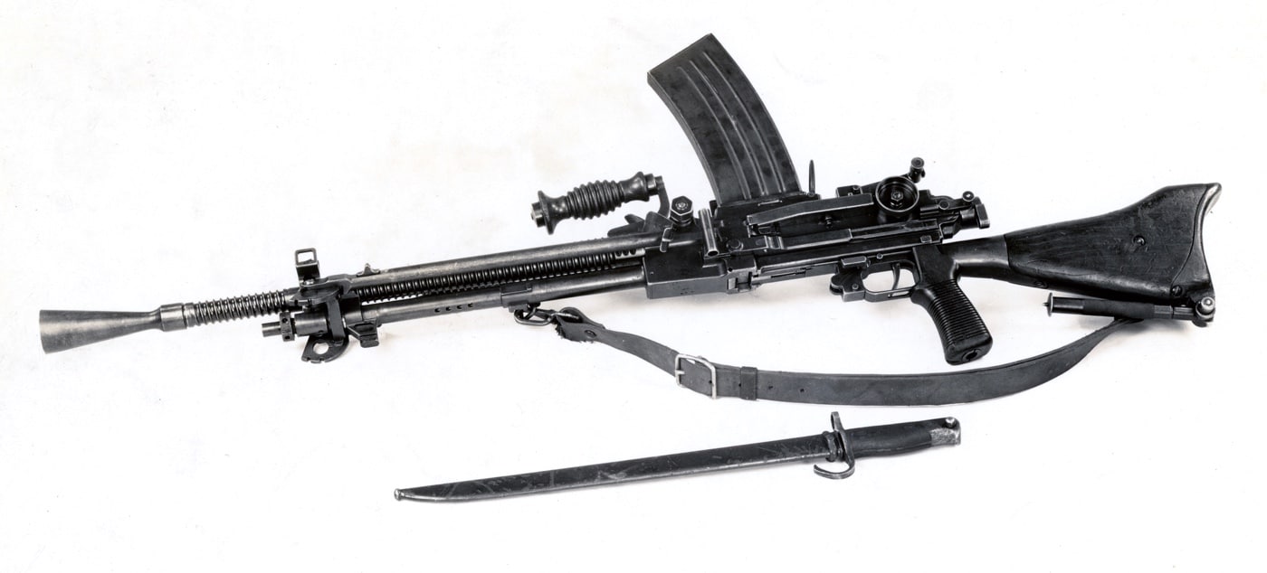

Japanese Type 99 Light Machine Gun
The Type 99 light machine gun could accept the standard Type 30 infantry bayonet. It is often seen with a flash hider on the muzzle and a monopod on the buttstock. Image: U.S. Army Ordnance Museum

The Type 99 is often seen with a large flash hider, which was screwed onto the threaded muzzle. There is also a monopod on the bottom of the Type 99’s buttstock. The barrel change operation on the Type 99 is more complex, as each barrel must be head-spaced to the gun. The weight of the Type 99 went up to 23 lbs., and the overall length went from 42” to 46½”. About 53,000 Type 99 LMGs were made by the end of the war.
