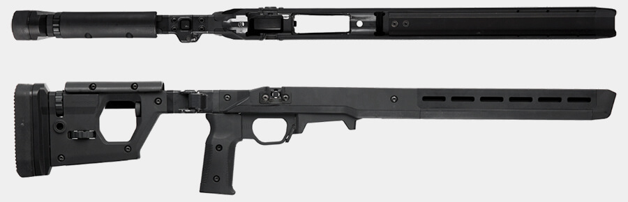

The Pro 700 is a strong, rigid, aluminum chassis with polymer skins and parts mated seamlessly together. This gives the Pro 700 a solid feel that lacks the cold, harsh feeling associated with some all-aluminum chassis systems.
The chassis is offered in a range of colors and both fixed and folding versions.
Magpul, the masters of development and refinement, spent two years developing the 700 Pro. The core is a 6061-T6 aluminum chassis, and it went through many iterations and countless broken parts before they settled on the current design.
The 700 Pro is fully adjustable, and it’s in this adjustability that the chassis really shines. It’s adjustable for comb height (cheek piece) with 1″ of travel. It also has +/- .375 inches fore and aft adjustability. It can also be adjusted for left- or right-sided shooting. The length of pull can be adjusted as well, with over 2″ of travel in this department. The butt is adjustable for height and cant as well.

Many other chassis systems possess this kind of adjustability, but not all have the ability to position the pistol grip. The grip on the Pro 700 has .75-inch of forward and rearward travel. The average shooter will overlook the importance of having the grip in the optimal position, while the experienced shooter understands the advantages of this.
The interchangeable pistol grip of the Pro 700 Chassis is adjustable for position as well. Image: Magpul
The grip and positioning of the strong (shooting hand) affects shot-to-shot consistency as well as recoil control, even though the rifle may be shouldered and supported by a bipod and rear bag. This feature will help accommodate shooters with different hand sizes and finger lengths, and can make all the difference in trigger manipulation. It also features interchangeable grips — one angled, one straight.
The Magpul Pro 700 further enhances the rifle shooter’s interface with a well-placed thumb shelf. This, with the grip positioning, delivers a relaxed and appropriate grip by the operator. It’s best that the thumb ride on the outside of the grip instead of wrapping the thumb around it, but that’s a discussion for another time.
Sean tested out the folding version of the Magpul chassis.
The 700 Pro comes in folding and fixed versions, and you can choose which side the folder version folds to by reversing the robust folding mechanism, which is an easy step. That said, you may want to choose the side that protects the bolt itself. If you decide later that you want a folding or non-folding stock, you can order a stock adapter from Magpul to set it up to your liking.
The Pro 700 features several attachment points on the forend and, of course, they are M-Lok style. This means you can add weights to the chassis if you’d like a heavier rifle, which is quite common these days, and it’s not a bad addition to the lightweight Waypoint with the carbon fiber barrel that I tested. There is also an M-Lok attachment point on the bottom side of the buttstock for monopods or a bagrider.
The Magpul chassis is set up to accept AICS magazines, which is the standard. In my opinion, Springfield was smart in making sure the Model 2020 used this magazine interface. Other options from Magpul for the Pro 700 include night vision rail, bipod, magazines, pic rail sections of various lengths, and even a full-length RRS Standard Dovetail/Arca rail. This interface makes accessory placement and removal much easier and could come in handy if you’d like to take your Waypoint into a precision rifle-style match that consists of challenging positional and barricade stages.
