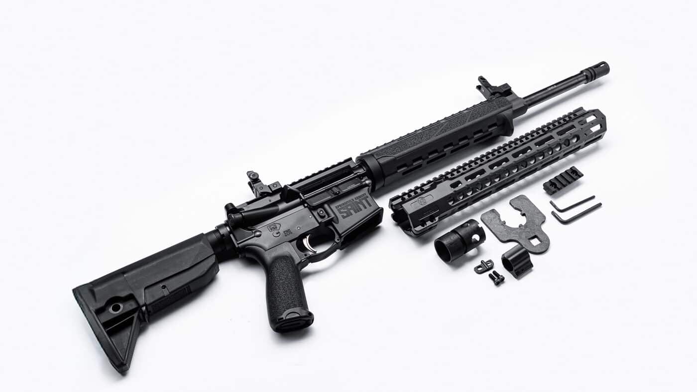

Midwest Combat Rail HD review
The test platform for this review was the author’s Springfield Armory SAINT rifle. It is shown here with the Midwest Industries Combat Rail HD and associated components.
I recently swapped a Midwest Industries Combat Rail HD, in the 13.5-inch length, and the company’s low-profile gas block onto a Springfield Armory SAINT 5.56 M-LOK rifle I have in my collection. The SAINT is an excellent and accessible rifle that does many things right out of the box, and I thought it would make a great host for trying out this rail.
