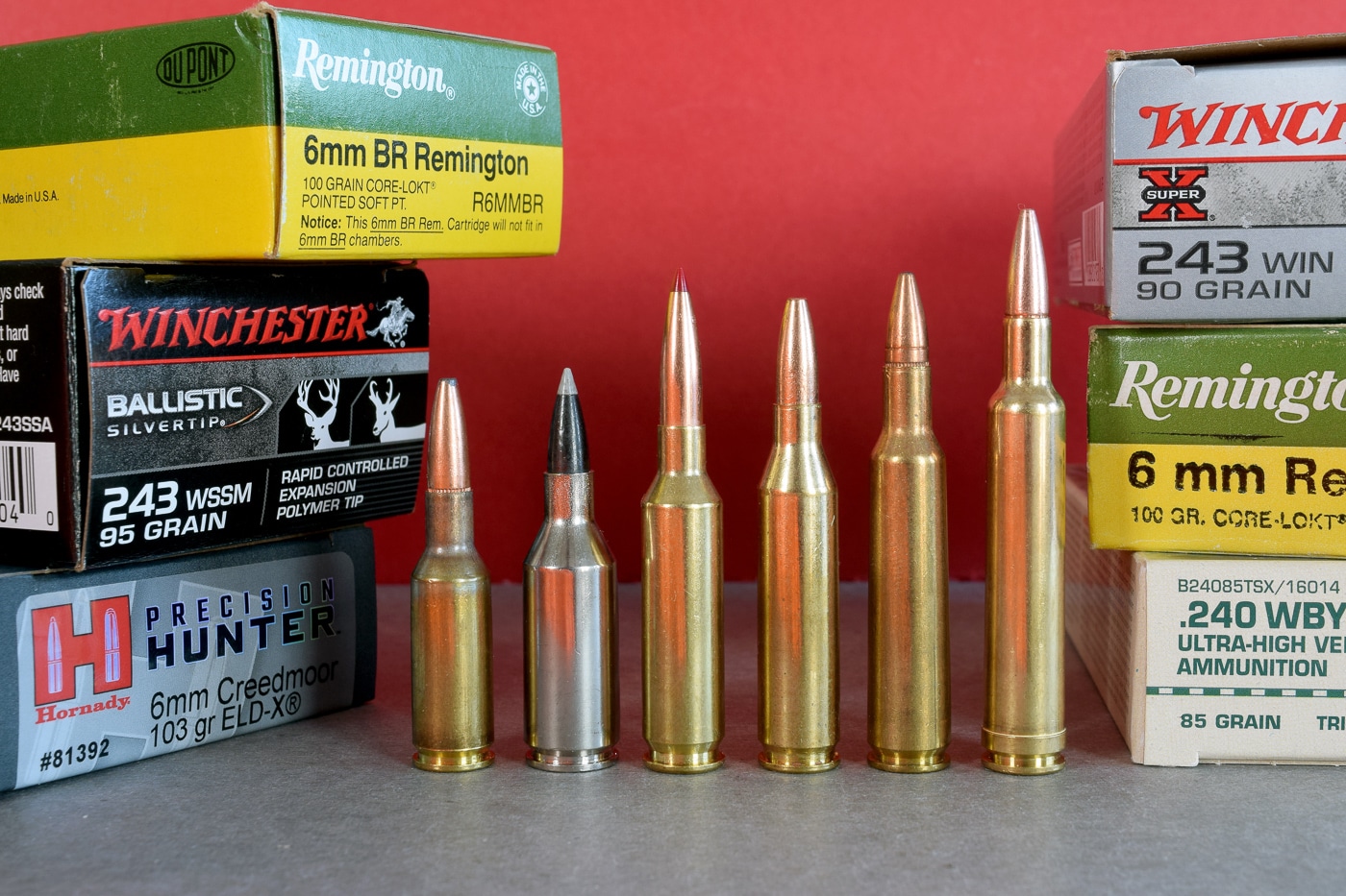

6mm cartridges
Some sixes have faded, while others have excelled. Shown from left to right: The 6mm Rem BR still competes; the .243 WSSM has had trouble gaining a solid footing; the 6mm CM does everything well; the .243 Win., 6mm Rem. and .240 Wby Magnum excel afield.
