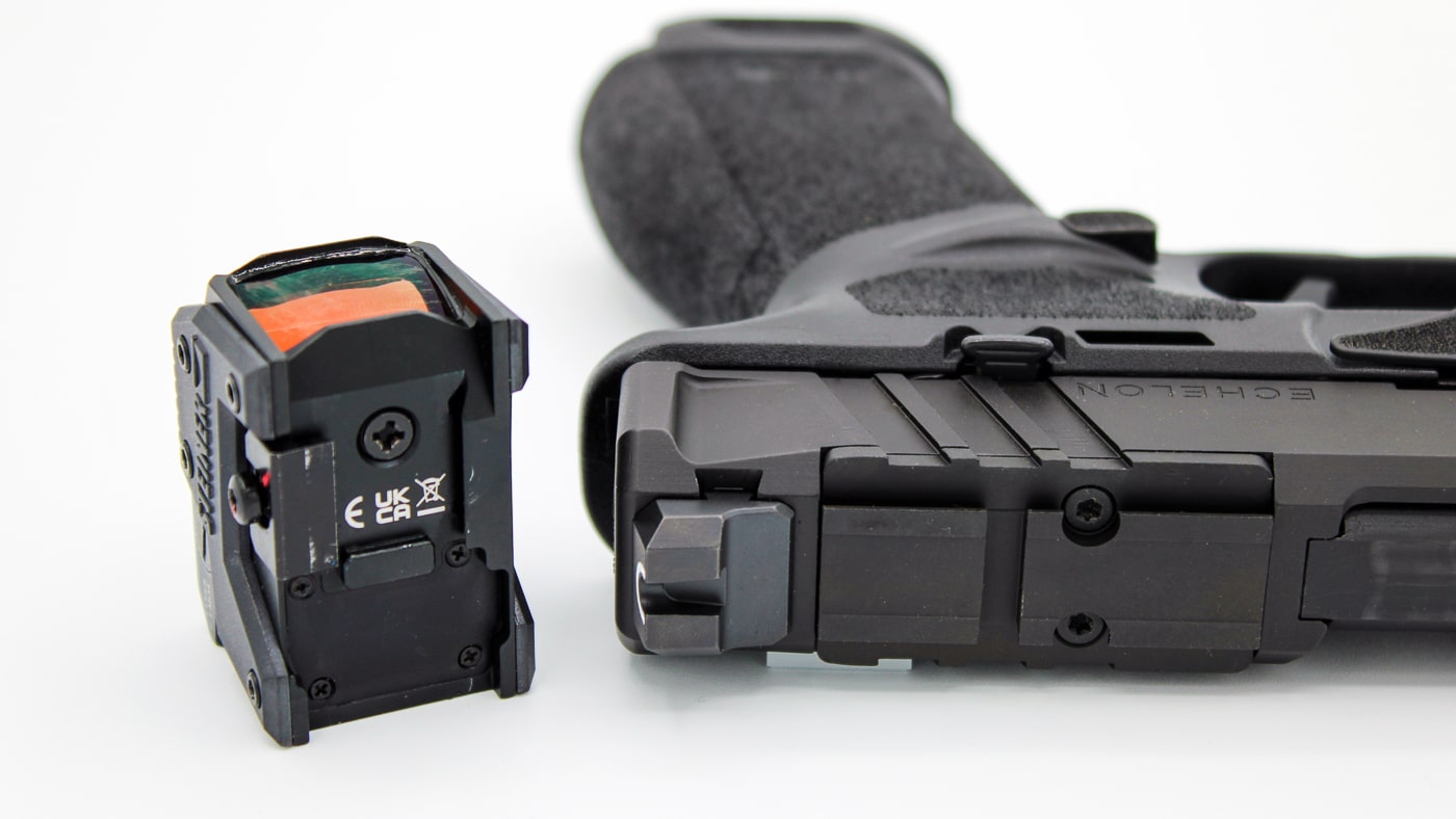

red dot footprints Steiner-MPS-and-ACRO-Plate
There are a variety of red dot optics on the market. Not all of them share the same mounting footprint. Shown here is a close-up of the Steiner MPS Bottom and plate for Springfield Echelon 4.0C.
