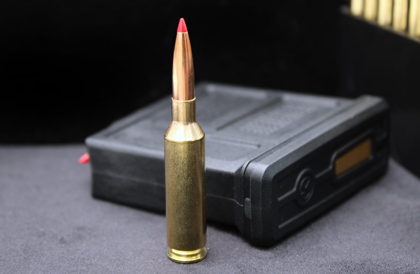

how does consistency impact ammunition accuracy
Are you aware of how much consistency in the your ammunition can impact your accuracy? It matters. A lot.
