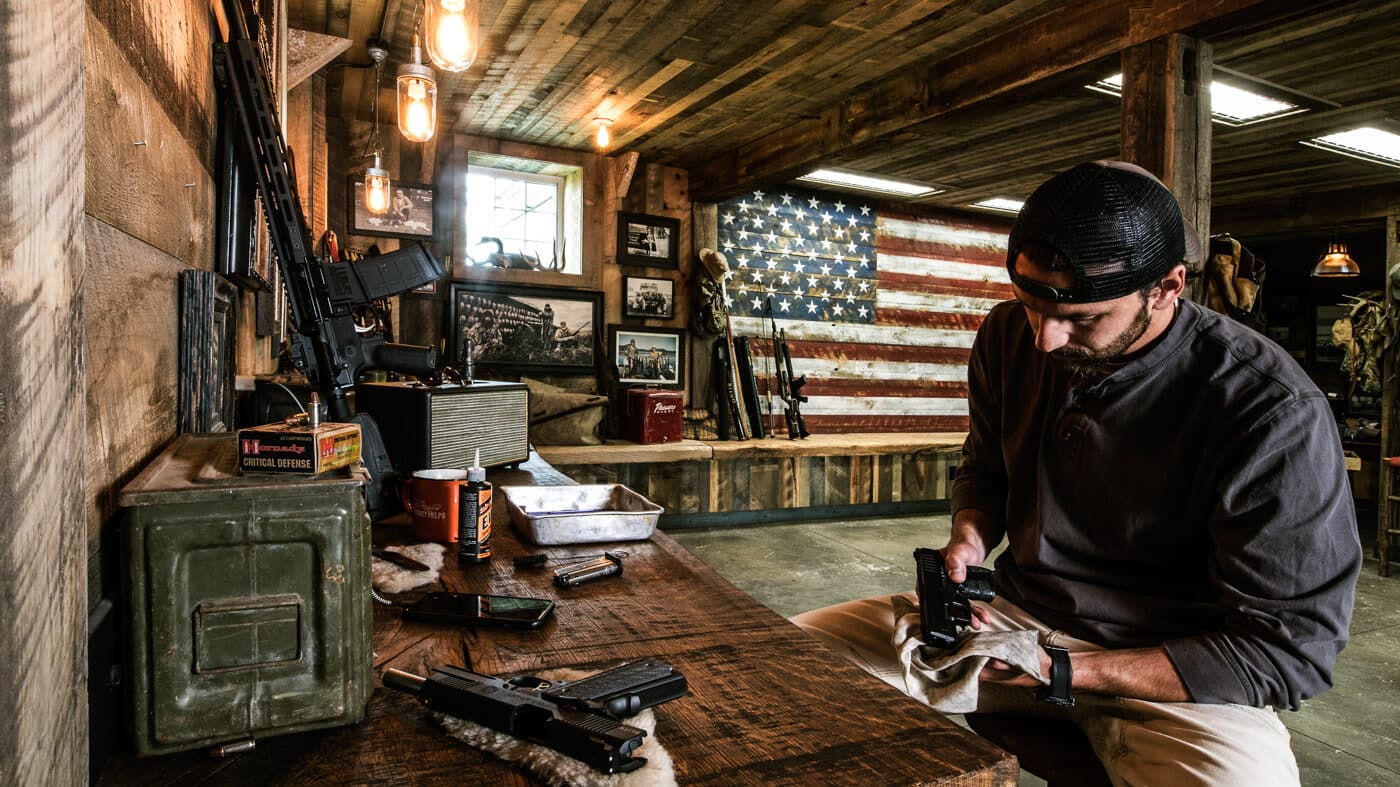

armorer working on XD-S Mod.2 on workbench
Any serious EDC enthusiasts takes the care and maintenance of his firearm seriously, as reliability is a must. But, what if you wanted to induce malfunctions?
