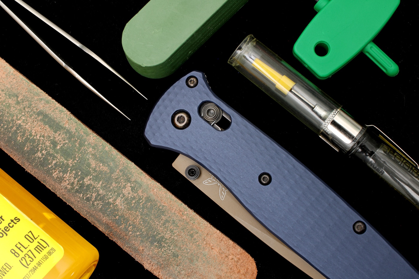

maintaining a folding knife
A folding knife makes so many tasks a lot easier. However, do you have the skills to ensure it remains in tip-top shape?
While today’s tips won’t do anything to keep your cutting tools in showroom condition (though if you ask me, a little honest surface wear has a beauty all of its own), it will help those of us who have been a little resistant to use our “nice knife” — whether it was gifted to us or whether we spent a little more on a design or super steel that caught our attention.
Just like a firearm, a quality knife will most likely outlast you and you needn’t fear putting it to work. Here are some of the tips and tools you’ll need to keep your knife sharp and well-maintained.
