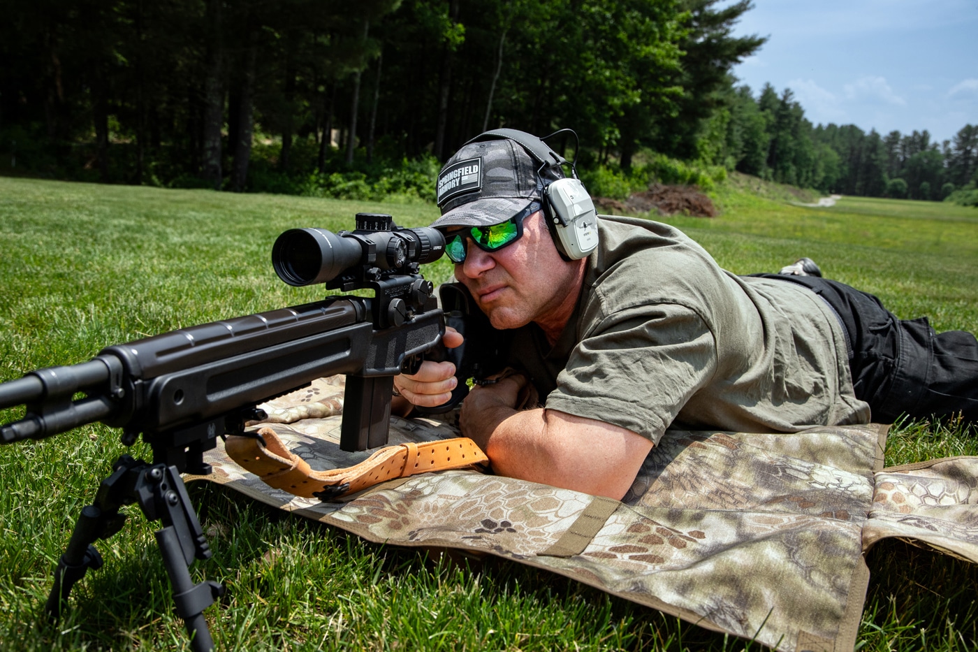

A shooter is lying prone at an outdoor shooting range with an M1A rifle, using a Leupold Mark 4HD 1.5-10x scope. The author is focused through the optic, testing how the scope performs in various lighting and distance scenarios. Spent casings and range markers are visible, indicating live-fire evaluation. This hands-on approach lets the shooter assess optical clarity, reticle visibility, and turret adjustment in a real environment. The scene highlights the Mark 4HD’s use in practical, mid- to long-range shooting situations.
Real-world test of the Leupold Mark 4HD 2.5-10x mounted on the author’s M1A rifle. Image: Harrison Rice
Those who do not fully understand things like mirage, range estimation and external ballistics might argue that a good shooter does not need the best equipment to hit the target. I disagree.
