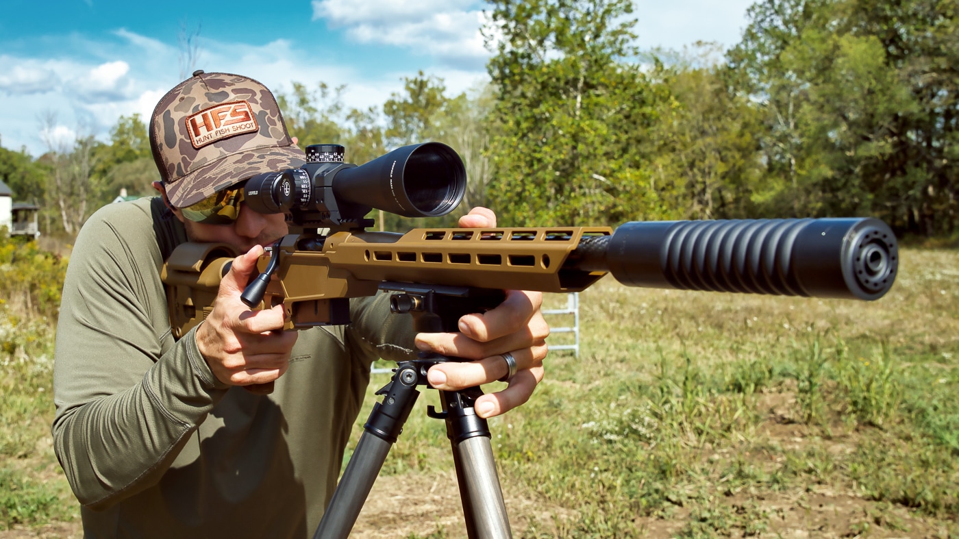

The author evaluates the Tricer-HK tripod system by shooting a scoped Springfield rifle from behind the ball head at a shooting range. Lightweight tripods must perform under live fire. The Tricer-HK tripod review demonstrates real-world durability. Carbon fiber construction withstands shooting stress effectively.
Evaluating this tripod means putting rounds downrange and seeing if it holds up to the hype. The lightweight design doesn’t compromise stability.
