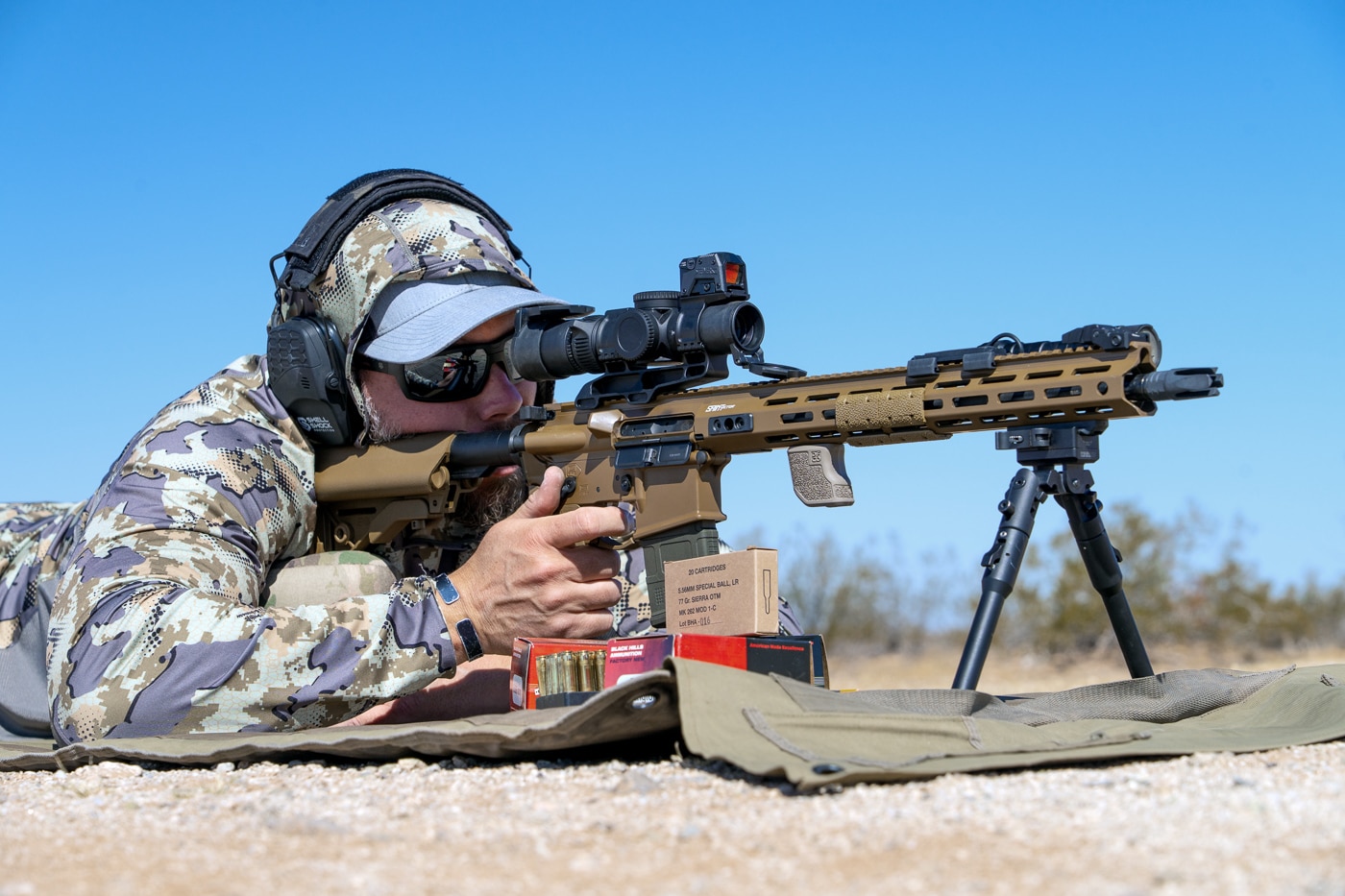

Vortex AMG 1-10X LPVO reviewed on the shooting range
The author shoots his Springfield Armory SAINT Victor with a mounted Vortex AMG 1-10X LPVO from a prone shooting position.

I figured the 16” Springfield Armory SAINT Victor was a great base rifle for this optic and mounted it into one of my favorite mounts from Zero Gravity. I have become a huge fan of the Zero Gravity mounts after using them in a class recently. They are light, strong, have a very nice ring attachment method, and give the ability to add a 12 o’clock red dot with their Sherpa Mount.
author testing the Vortex scope on the shooting range from a prone position
The author drops into a prone position and actively runs the Vortex AMG 1-10X, focusing on stability and precision as shots break downrange.
Since it is an all-around-use rifle, I added a Streamlight Protac HLX light, Die Free Company foregrip, and used a Warne Skyline Lite bipod for the initial zero and accuracy testing. For ammunition, I used Black Hills Mk-262 MOD 1C 77 grain, 69-gr. OTM, 77-gr. OTM and 75-gr. Match HP. I do have to say the Black Hills ammo performed and I shot some of the best groups I have in a while.
